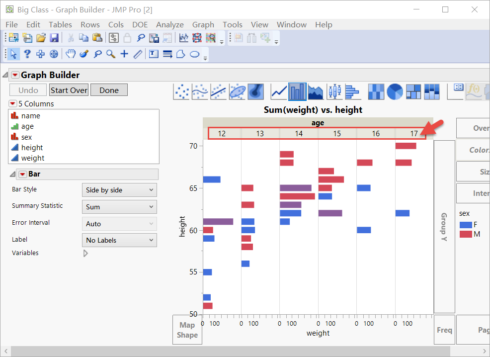

Where is this font size set for JMP mapping?
The font the arrow points to.
Thanks!
p1 = dt << Graph Builder(
	Variables( X( :weight ), Y( :height ), Group X( :age ), Color( :sex ) ),
	Elements( Bar( X, Y, Legend( 5 ), Response Axis( "X" ), Summary Statistic( "Sum" ) ) )

Re: Where is this font size set for JMP mapping?
Use
Names Default To Here( 1 );
Get Preferences( );
and then in the log you will see the structure for the preference in question and you will then be able to use
Preferences (	Fonts(
		English(
			Text Font( "Segoe UI", 9 )
Jim

回复: Where is this font size set for JMP mapping?
  • Of course, it can not be adjusted individually, and the overall font of the drawing can be reduced.
Thanks Experts!
I tried again. It could only be this.I thought it was the scope of the graph, so I didn't find it before.
Thanks!
I think that is controlled by "Text" font size (like many other things).
Wish list item Right-click to change Group font and font size
-Jarmo
Yes, this is obviously not a good idea.
In order to reduce the font there, the result is that the font in many other places is reduced.
Thanks!
How do I use the JSL implementation to change the Text font in Font in Preferences from 9 to 12?
Thanks Experts!
Set Preferences( Fonts( Text( Size( 12 ) ) ) );//?
Use
Get Preferences( );
		English(
Jim
Thank Jim!
