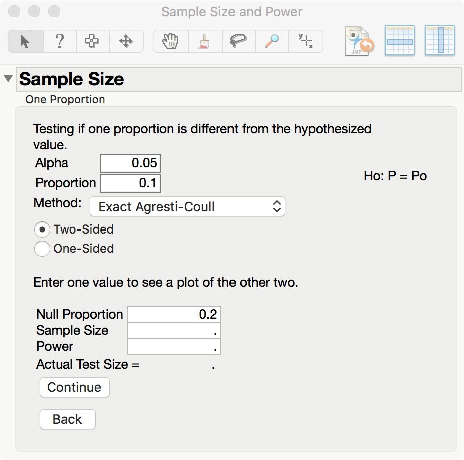

Re: Where is the binomial reliability calculation hiding?
Help > Books > Design of Experiments Guide. There is an entire chapter about the sample size and power calculators.
