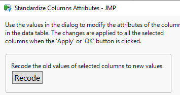

what can not be undone:
3) recode of multiple columns via Cols/Standardize Attributes/Recode
