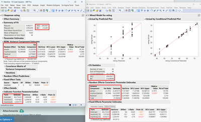

If you don't have specific covariance structure (setting structure = Residual : no covariance between observations, so the errors are independent), you can build the model either with the Standard Least Square personality with random effects or with the Mixed Model personality, and you will obtain the same results.
For illustration, I tried it with the dataset "Machine", and the two models are the same with the platforms, as the covariance structure is set on "Residual" :
