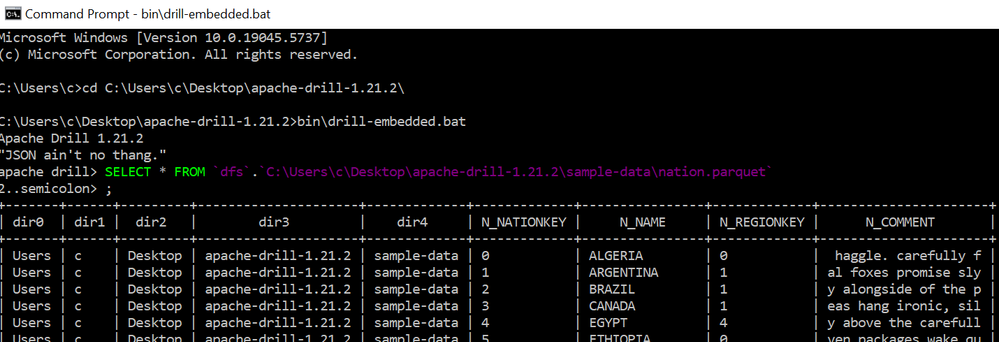

The Python approach is probably better than what follows. But this does work, at least with a toy parquet file.
There is an Apache Drill project that can read parquet files; it wants to be a JDBC (java, not ODBC unfortunately) and the ODBC drivers for it, if they still exist, might not be free. But it has a REST based api and JSL can do that.
This post steps 1,2,3 pointed in the right direction (thanks @ robertspierre). Not sure how you'll extract the file on win; Linux can do it and some window tool can probably do it too. I used https://drill.apache.org/download/ and picked "Drill for Hadoop 3 and non-Hadoop environments, direct download". I also got microsoft-jdk-21.0.6-windows-x64.msi from https://learn.microsoft.com/en-us/java/openjdk/download .
I left the expanded apache-drill-1.21.2 directory (from the tar.gz) on the desktop and started it like this:
cd into apache-drill-1.21.2 then run bin/drill-embedded.bat.  I then played with a query against a supplied parquet file, which you don't have to do because...start JMP and run this script:

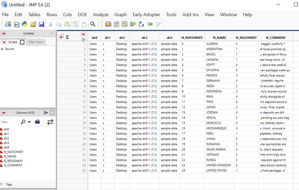

fields = Associative Array();
fields["queryType"] = "SQL";
fields["query"] = "SELECT * FROM `dfs`.`C:\Users\c\Desktop\apache-drill-1.21.2\sample-data\nation.parquet`";
s = New HTTP Request( URL( "localhost:8047/query.json" ), Method( "POST" ), JSON( Fields( fields ) ), Headers( {"Accept: application/json"} ) ) <<Send;
dt = open(chartoblob(s),json,guess("tall"))
and get this table:

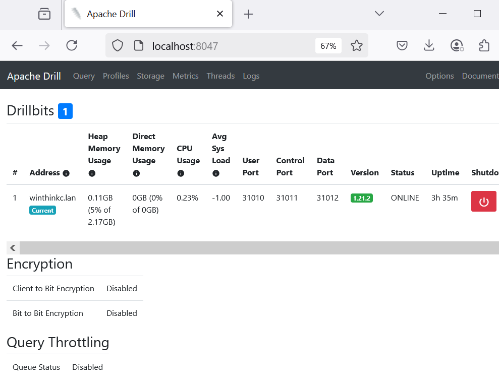

When you start the drill process above, it is launching a webserver that handled the REST api request from JSL; it also has a web interface, which I don't think is going to be interesting for reading parquet files.
https://drill.apache.org/docs/rest-api-introduction/#query might help with the api.

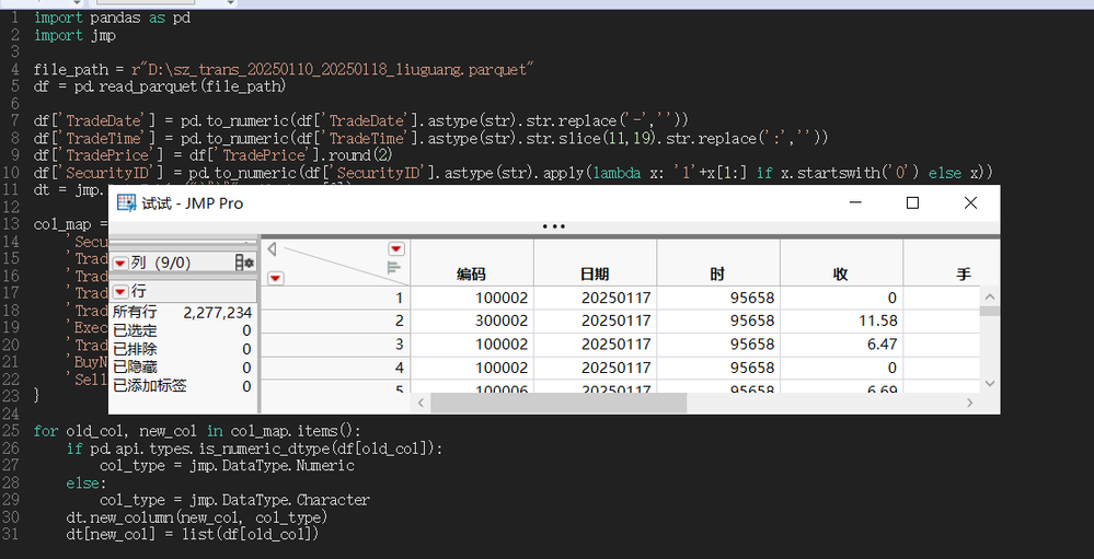

lala
Level IX
Re: Importing large Parquet files into JMP
I'm so slow with the grok3 method
