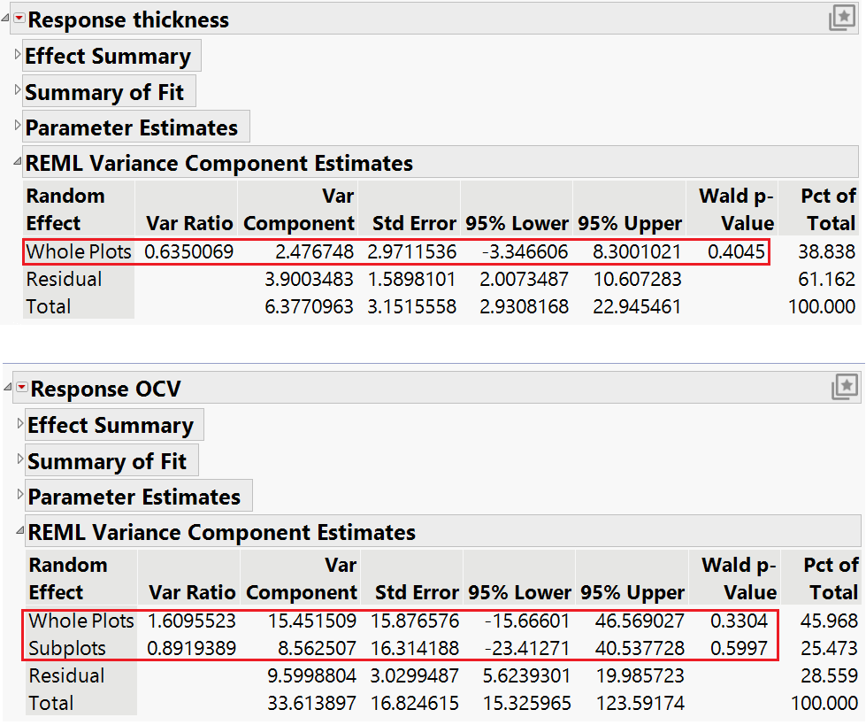

When conducting analysis of split-plot design experiments, if the Wald p-value for Whole Plots or Subplots is relatively large, should Whole Plots or Subplots be removed?

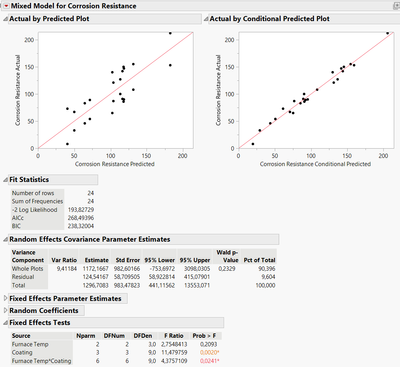

Here is an example with Box Corrosion Split-Plot JMP dataset. The Whole plot effect is not significant like in your example (but still capture 90% of the total variance, whereas in your case whole plots+subplots random effects capture more than 70% of the total variance for OCV, and whole plot random effect capture more than 38% of the total variance for thickness) :
But take a look at p-values of the fixed effect tests.

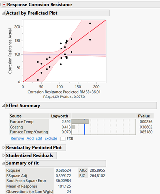

Now when I'm relaunching the same model without whole plots random effects, the interaction effect and coating effect don't appear statistically significant (but furnace temp does) :
And the parameters estimation have higher standard errors for the hard-to-change factor (coating) and any interaction involving it (even if the parameter estimates have the same value) :
(Left: mixed model report / Right: Standard Least Squares model report)
