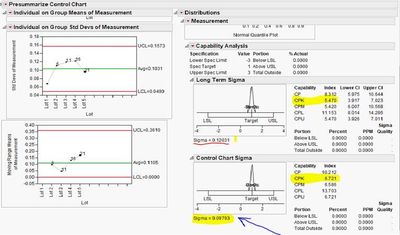

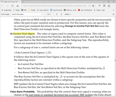

I have scanned the JMP Book "Quality and Process Methods" and did not find a definitive answer, but my best estimation is that it is the In-Control Sigma. Here is an excerpt from the book:
Jim
