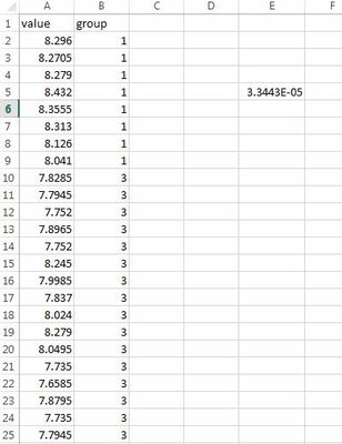

However, when I do the same test on the raw data in excel (formatted as the table below)
using the "T-test" function in excel with the following format "=TTEST(A2:A9,A10:A25,2,2)" (choosing a test between group #1 and group #3) the value I get is much different than the one I get in JMP (0.2549).  Can anybody give a reason what the difference might be?

I am not sure what you got in Excel but it looks to me that one difference is that JMP will use a common estimate of the variablility based on all 5 groups while Excel is just estimating the variability from Groups 1 and 3.  This could make your p-values different.

ToddS:  I believe you are correct. I have investigated this issue before and came to a similar conclusion.
Tei: If you run the same t-test in JMP on just the subset of data containing groups 1 and 3 you should be able to confirm that the p-values between Excel and JMP agree in this limiting case.
