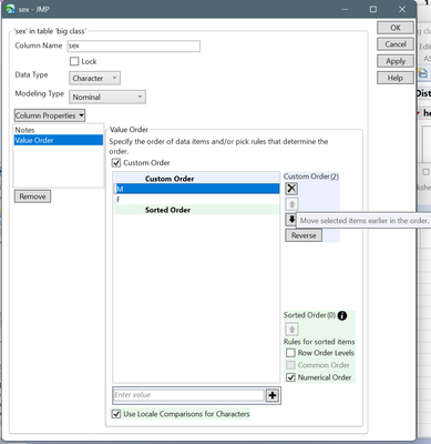

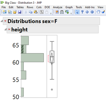

I expected the value order of a column to define which value is shown first in analysis platforms when grouping by that column, but this does not seem to be the case (sex=F is always shown first in big class).
My question is twofold:
1. can I affect which is shown first?
2. If not, how do I know which comes first? It does not appear to be alphabetical

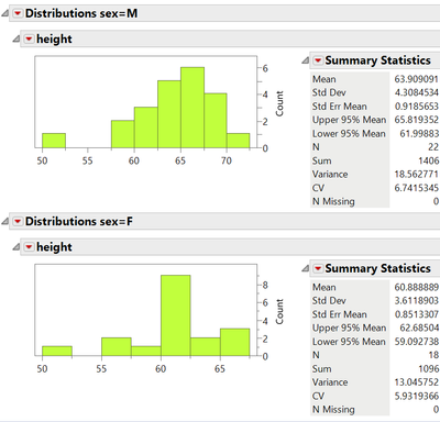

But today it does? This was on JMP 17 but I think this has been working for a while.
hogi
Level XIII
Re: What determines the order of the platforms in a group-by analysis
Yes, works with jmp 16 and 17.
