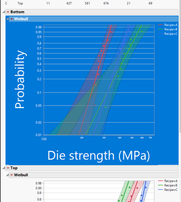

The best option I can currently think of (other than actual screenshots) is sending an individual selection to a journal and then export the journal as an image. This seems like a cumbersome step for a single image however.

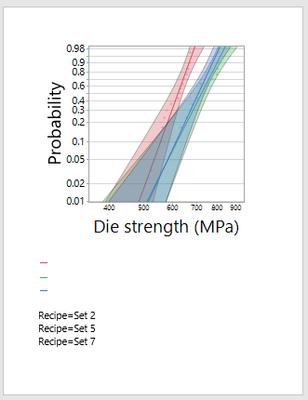

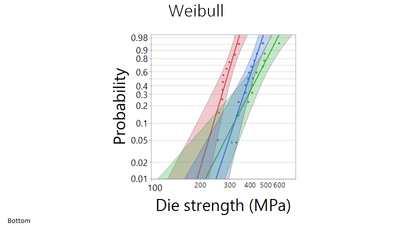

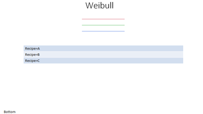

So I figured if I want multiple figures from a platform I would send them to a journal and then export the journal as ppt so that I can later use the individual images in my reports. However, when I export a journal to ppt the layout of the legend is completely destroyed.
Any help is appreciated, I attached my journal for your reference.
Graph in journal
Output in ppt after exporting

What I do is export the journal as an rtf document, open in Word and then re-size/format in Word.  When you export to PPT, it puts every graph/pic on a separate page and hence the mixed up legend.

Exporting to rtf results in the same unreadable format. This split between legend and graph is clearly unwanted behavior for most use cases of journal exports; I don't see when this output would be useful.

  1. Use the selection tool in JMP (s) to select only what you want in another document (highlighted in blue below)
