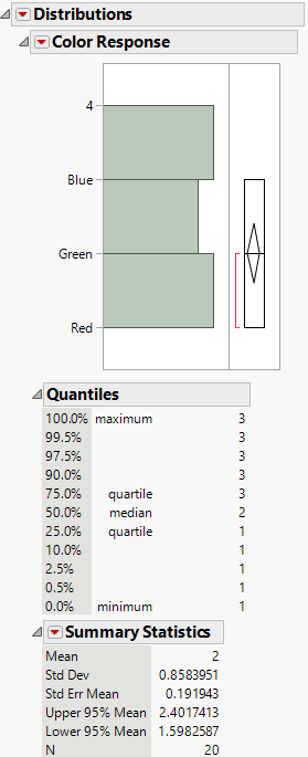

I'm trying to pull some summary statistics out of a weighted dataset (e.g., proportion of the population that has blue as a favorite colour). However, JMP does not seem to automatically weight counts. Is there a way to get JMP to produce the weighted count?
Yes, I am using the distribution command under Analyze. The variable I'm looking at has been assigned to being nominal, and I've included my weight variable.
I have two variables; colour preference and weight. Colour preference are nominal, and weight is continuous. I have a sample of 8,000 that is scaled to a population of 30,000.
Try using your weight as the frequency. I am assuming your data tabel has 8000 rows and you have a coulm that "weights" each row to the proprotion of the full population that it represents. So this "wegithing" column is the "frequency" of that response in the population. To get your population counts from your sample use your response (color) as your Y and the "weight" as the FREQ column. Then you will get something like this (my example has N = 28741 rows weighted to a population of N = 955968818)
