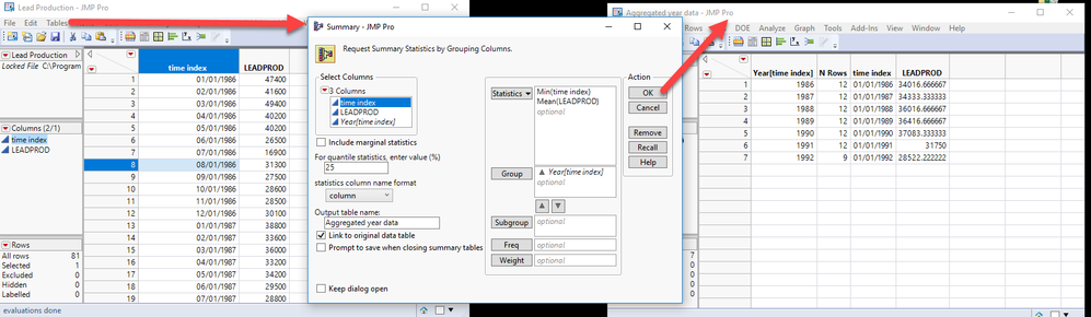

I have a table with a column that is my time index.
This column is in minutes and I want to calculate statistics aggregating the results but per hour, for example.
How to do that?

One way to do this I found:
Tables>Summary and Grouping by Date and Hour (in this order).
To have a column with the complete date, and not splitted by two: include in the Statistics min(Date), being median or max are also possible.
Here is a simpler example aggregating the Lead Production Data table by year.
