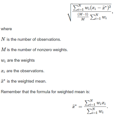

Hi Mark,
I am drowning in my own ignorance...
I  calculated  the weighted mean of a dataset in Excel and compared it to JMP. The results did not match.
The formula I used in is:
This agrees with the code except:
var = ss / (N Row( y )-1);			// weighted variance, unbiased
should be:
var = ss / ((N Row( y )-1/N Row(y))*n;			// weighted variance, unbiased
Clearly I do not understand  this.
Thank you
Fanie
Re: Weighted Standard Deviation
It is not a matter of ignorance. There are at least four definitions of the weight standard deviation or variance. The definitions differ only in the denominator that is used. That is to say that the weighted mean and weight sum of squares are the same in all the definitions. JMP only implements one of the four definitions. Other software might implement this definition or one of the others.
