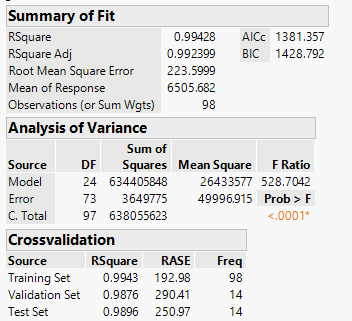

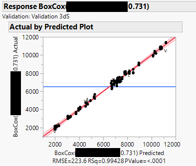

Hi All, I appreciate your time and response. I have built a model using main effects, interactions, and sometimes 2nd orders. I have used Standard Least Squares and 60% of the data. About 20% is used for validation and 20% for test sets.
R2, adj R2, and those for validation and test sets are all about 98-99%. VIFs are all between 1 to 2.

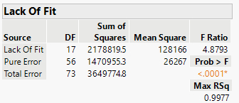

The only issue is I have a significant lack of fit.
What can I do here? Can I ignore the LoF?

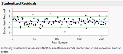

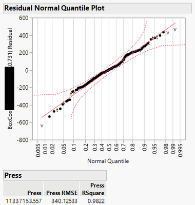

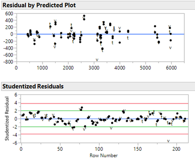

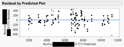

Thanks for the quick reply @P_Bartell. Please see the attached picture for residuals. I don't think they look problematic?!
The model is going to be used for both optimizations, currently, and in the near future for predictions. The wrongness of prediction is not going to be too impactful.

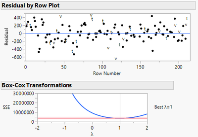

How do the residuals vs. predictor variable plots appear? This can be a hint to missing terms or effects in the model. And the residual vs. run order (if you ran a designed experiment) appear? This can indicate a non stable variance or some other lurking variables effect that may have entered the experimental execution event which could also lead to LOF.
From the looks of your Predicted vs. Residual plot methinks the primary cause of the LOF is a relatively small variance for most of the replicate points. This makes a really small Pure Error term vs. the LOF error term in the LOF ANOVA and makes a 'significant LOF' p-value more likely.
As you state the magnitude of the difference between the actual and predicted values is not practically significant so if the model can still be used for it's intended purpose...oh well, you've LOF. Who cares?

Thanks again for the kind answer @P_Bartell , I agree with the relatively small variance for most of the replicate points.

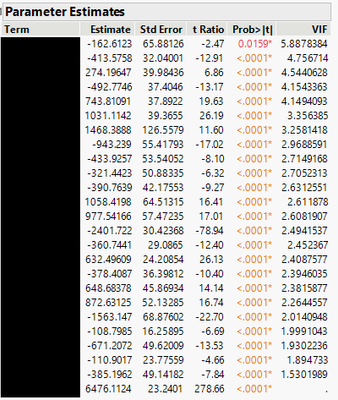

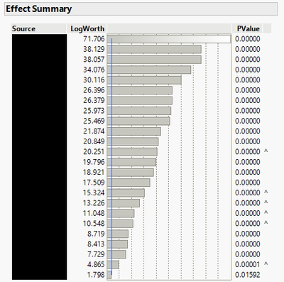

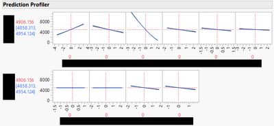

To answer your questions, I have included another screenshot.
