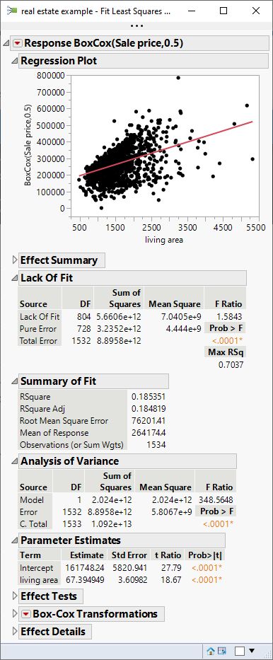

Weighting in this linear regression is by reciprocal variance, but the variance function might be difficult to determine in this case. So there are other techniques that can help. The first technique is to transform the response and therefore alter the variance. The Box-Cox transformation is used for several purposes, including stabilizing the response variance. The command is in the Factor Profiling sub-menu under the red triangle for Fit Least Squares. Here is the linear regression using the transformed response:
I didn't spend any time selecting the lambda parameter for the transformation, so you might do better with another value, but you can see that the residual pattern is different and getting closer to constant variance.

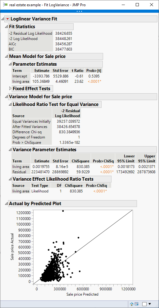

The second technique is to use a method that models the mean response and the response variance, and uses the variance function when regressing the mean. Change the fitting personality in the Fit Model launch dialog to Loglinear Variance and add living area as the effect for the second model. You are now fitting two models. One models the mean response and the other models the response variance. Both of them have living area as the sole predictor. The result is this:
The dependent variance is properly accounted for in this model. Of course, the residual pattern will still show that the variance is not constant. The only way to avoid that is to transform the response to stabilize the variance, but that should not be a goal in and of itself. You were just trying to handle the violation of assumption of constant variance in ordinary least squares regression.

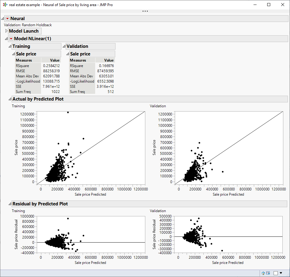

The third technique is to use another predictive model that does not assume constant variance. Here is the Neural model:
The residual pattern without transforming the response is the same as the unweighted linear regression, but the neural model estimation does not assume constant variance.
