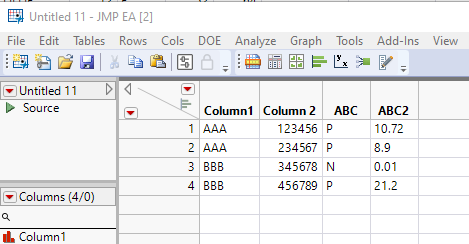

Move data from a row to a column for duplicates, then remove duplicates
New JMP user here. I know how to do this in Excel, but am not sure how to in JMP.
Here 's my dataset:
Column1Column 2Column 3Column 4
AAA123456ABCP
AAA123456ABC210.72
AAA234567ABCP
AAA234567ABC28.9
BBB345678ABCN
BBB345678ABC20.01
BBB456789ABCP
BBB456789ABC221.2
Here's what I want my data to look like:
Column1Column 2Column 3Column 4Column 5
AAA123456ABCP10.72
AAA234567ABCP8.9
BBB345678ABCN0.01
BBB456789ABCP21.2
Any and all help is greatly appreciated!
txnelson
Re: Move data from a row to a column for duplicates, then remove duplicates
You can use
     Tables=>Split
pull down menu to do this
In the Split dialog box,
    Select Column 3 as the Split By column
    Select Column r as the Split Columns
    Select Column 1 and Column 2 as the Group columns
Jim
Thank you so much! That worked well!
