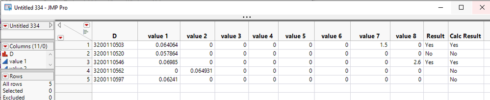

D value 1 value 2 value 3 value 4 value 5 value 6 value 7 value 8 Result
3200110503 0.064064 0 0 0 0 0 1.5 0 Yes
3200110520 0.057864 0 0 0 0 0 0 0 No
3200110546 0.06985 0 0 0 0 0 0 2.6 Yes
3200110562 0 0.064931 0 0 0 0 0 0
3200110597 0.06241 0 0 0 0 0 0 0
I am referring to check each column for each row to look for two conditions:
1. Check each column to identify any column has value greater than 0 and less than1.
2. Check each column again to identify if any column has value greater than 1.
3. If statement 1 and statement 2 is true for any row, then i report value Yes. If false, then i report value No.
Thanks again for helping.

Here is a hardcoded straight forward piece of formula that will create the results you want, given your latest description
If(
	(:value 1 > 0 & :value 1 < 1 | :value 2 > 0 & :value 2 < 1 | :value 3 > 0 &
	:value 3 < 1 | :value 4 > 0 & :value 4 < 1 | :value 5 > 0 & :value 5 < 1 |
	:value 6 > 0 & :value 6 < 1 | :value 7 > 0 & :value 7 < 1 | :value 8 > 0 &
	:value 8 < 1) & Max(
		:value 1,
		:value 2,
		:value 3,
		:value 4,
		:value 5,
		:value 6,
		:value 7,
		:value 8
	) > 1,
	"Yes",
	"No"
