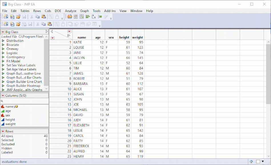

Select values from report table or clipboard in local data filter
Is there a way to interactively select values from a table (data table or table in a report) and transfer those into a local data filter?
Asking another way: it is straight forward to get values into a one-per-line list into the clipboard, can those be somehow selected in local data filter, or is there an alternate way to do this?
Here is an example workflow:
Thanks!

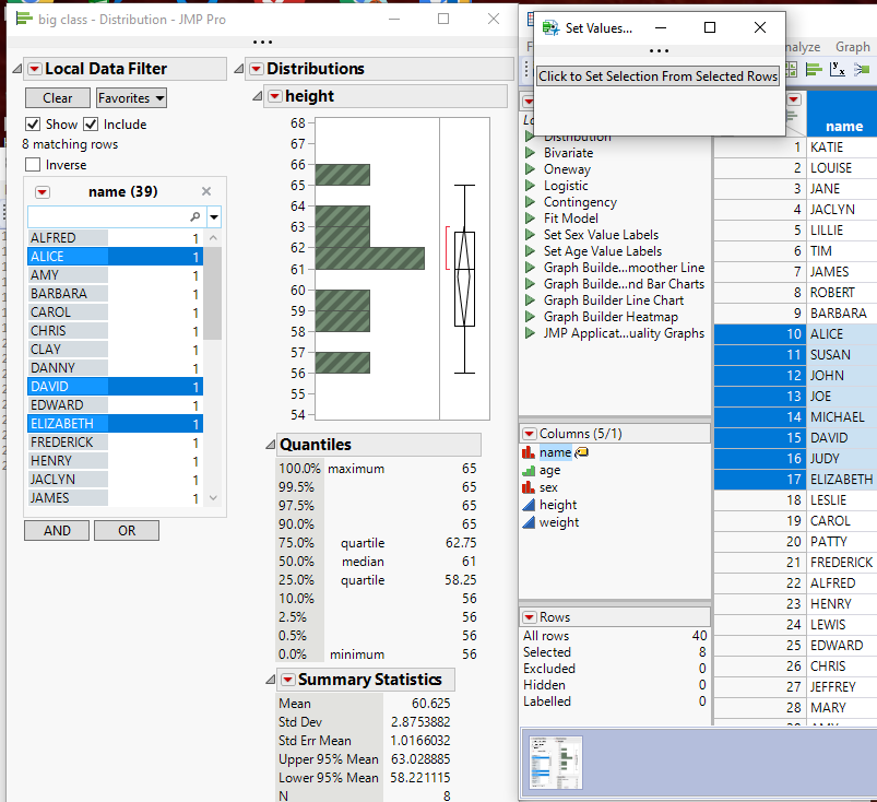

There may be better ways to do this, but here is my take on it.  If you create a separate window, with just a Button Box() in it, clicking on the button will run a simple script that can change the filter
Here is the script that produces the above example

Another thought,
This could be automated by applying a Row State Handler on the data table.  Anytime a rowstate changed, it would trigger the running of the code that is currently in the Button Box, and update the local filter.

Looks like it will be an add-in with your button-box script to the rescue!
Thank you @txnelson.  Will leave the post 'unsolved' for a bit just in case anyone comes up with no-script solution...
