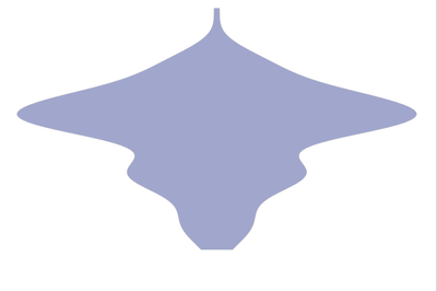

Hello all,
I have a continuous variable that I would like to display where the more frequent entries cause the plot to be wider and have a gradient of colors from the min-max of the data range. I can create a scatter point plot that is CLOSE to what I want (not sure why the gradient colors are faded). To get there, I drag the variable to the Y axis and then also drag that same variable to the "Color" area on the right.
But as soon as I click the contour/violin plot, the gradient colors are lost and here is what I'm left with:
I can't figure out how to regain the gradient color when in that mode. Any help would be appreciated.
Additionally, how can I created a float line to depict the median value of the data series? Thanks

Re: Violin plot with gradient
There is not a gradient option with violin. I like the idea, and you should put it in to the JMP Wish list
