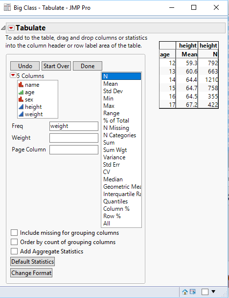

I believe you want to use the Freq capability in the JMP Procedures.....below is an example with a dummy data table, the Weight column is specified in the Freq selection areaweighted.PNG

Jim,
Ahh .. got it. Perhaps I got confused between Weight and Freq procedures in JMP. I did additional reading on the SAS documentation website where they distinguish between both the procedures (http://support.sas.com/kb/22/600.html). Thank you.
One more question: is there a way we could "Tabulate" the Weighted and Unweighted N on the same table using the Tabulate procedure?
