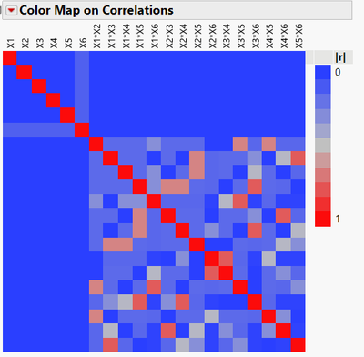

  2. Color map on Correlations : You should have no correlations between main effects, and between main effects and 2-factors interactions, so you end up with this kind of pattern :
    Here, I have a very small correlation in the main effects area due to the presence of the categorical factor X6, but if you have only continuous factors, you won't have this small border. Looking at the Alias matrix also can help checking if there are no complete confounding (which could be present in classical factorial designs).

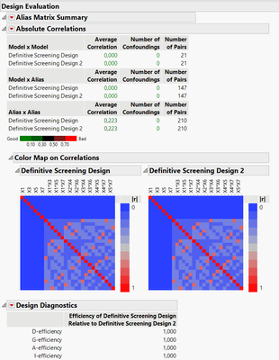

  • The additional 4 recommended runs by JMP correspond to adding 2 fake factors in a DSD. You can do the test and compare the designs (DSD with 4 extra runs and DSD with 2 fake factors), they should be identical :
Hope this answer will help you :)
