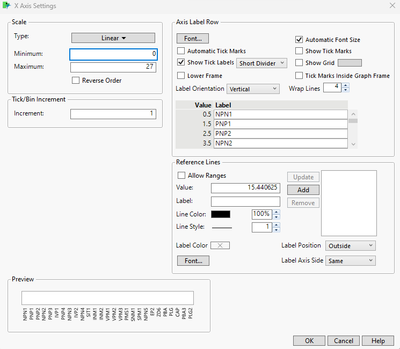

Try going to the Axis Settings for the X axis and changing the Label Orientation to see if that will allow for more of the tick marks to have labels. Also, check to make sure the Increment is set to 1.

Hi @Julianveda : I've had this issue with a few platforms, and it is a matter of space; there is not enough room to show all the variable names in a way that is readable. My way to resolve it was to reduce the font-size and make the labels vertical (right-click on axis to see these kinds of options).

Thank you @MRB3855 for your answer. I tried this in hierarchical clustering platform but unfortunately, it did not work :(

Thank you @txnelson, The advice about the increment did the work :)
