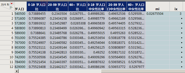

How to use JMP software JSL to efficiently find the minimum value?
How to use JMP software JSL to efficiently find the minimum value in the same row, multiple columns, and the rank of the column in which the minimum value resides.
dt = Open( "$SAMPLE_DATA/PopAgeGroup.jmp" );
New Column( "mi" );
New Column( "ix" );
Column( "mi" ) << Formula( ? );
dt << run formulas;
Column( "mi" ) << deleteFormula;
Column( "ix" ) << Formula( ? );
dt << run formulas;
Column( "ix" ) << deleteFormula;

Thanks!
Column( "mi" ) << Formula(r=row();min( dt[r,8::13]) );
Column( "ix" ) << Formula(r=row();contains(dt[r,8::13],min( dt[r,8::13]) ));
