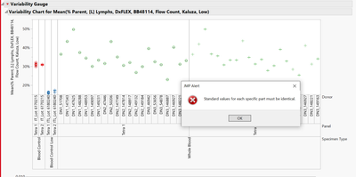

Variability Gauge Bias Report Error
When attempting to run the Bias Report in the MSA module, I receive this error. I'm not quite sure what it means or how to rectify it. Please help.

I think you have a data problem. One column should identify the part. Another column should provide the associated standard value. It appears that some standard values for the same part contradict other values.
I suggest launching the Distribution platform with the part ID and standard value columns. Select each part in turn in the histogram (click on the bar) and see if there are instances with more than one standard value.
You could also temporarily change the modeling type of standard value to nominal. Then select Tables > Summary, enter both part ID and standard value as a group and click OK. The table you get should also help identify the problem.

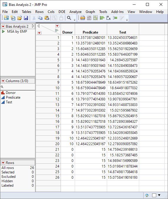

I created an example for this MSA. I hope it illustrates the data, data layout, and analysis launch that should work. First of all, your data should have a layout similar to this example:

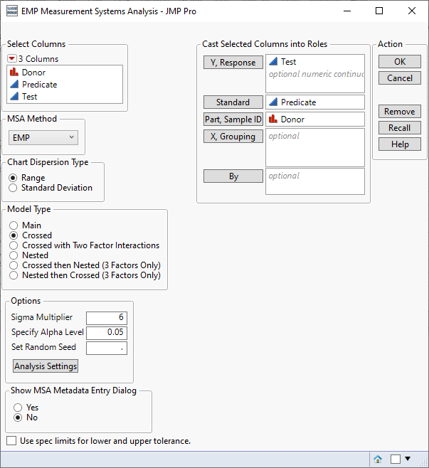

The MSA should be launched like this:
After selecting the Linearity and Bias Test from the platform menu, you should not see that error message. You should see a report like this:
Here is the script I used to create this example:
