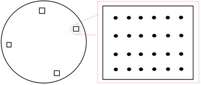

Hello,
I work in the semiconductor industry. Let's say I have a wafer.  This wafer has dies spread around the wafer, as shown. Within each die there are rows / columns each representing gradients of some metric at a specified point. From left to right, for instance, metric A starts at a max value and dwindles to the min on the right.  From top to bottom, metric B follows the same pattern.
I've set up a wafer map shape where each shape number is the die. However, the values for any colored metric is averaged within the die because of the map shape.  Is there a way to change this averaging behavior into a contour map, within each die? If I click on the contour option in the Graph Builder, the visualization goes blank.
I've been searching for this, but I haven't found answers.
Thank you in advance!

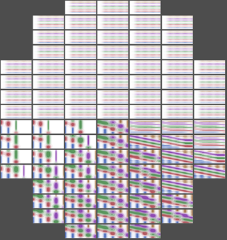

You could use a lineup box to hold a contour plot for each die, something like this
The gray rectangles are beyond the edge of the wafer.The gray rectangles are beyond the edge of the wafer.

I took a picture of each contour plot, moderately large, both to be able to close the platform and delete the dummy data and to minimize the appearance of some pixels around the edge of the picture. Later, I scale the big composite picture down. The LineupBox is never displayed (you could, for debugging), but the picture of the lineup is displayed at the end.
I have not thought through the legend and how to make it common across the graphs. I think it is possible to specify the legend ranges.
You can use img<<savepicture to capture the image, or you might want to add some more displayboxes with information about the wafer before capturing the picture.
It does take a couple of minutes to run the example.

This may be a viable solution, @Craige_Hales! A very creative workaround!  Thank you!
