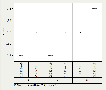

I tried rotating the group labels in tha var chart that your attached file produced. It worked fine. Both manually and by the jsl code below. I am using JMP 9.03 for Mac. I include a picture so you can tell if I have understood the problem correctly.
vc = Variability Chart(
          Y( :Y data ),
          X( :X Group 1, :X Group 2 ),
          Analysis Type( Name( "Choose best analysis (EMS REML Bayesian)" ) ),
          Process Variation( 0 ),
          Std Dev Chart( 0 )
Report( vc )[nomaxisbox( 1 )] << rotated tick labels( 1 );

Thanks for checking MS,
Exactly what I am trying to do but those same methods aren't rotating the text for me - they just shift the text slightly. They used to rotate the text just fine.   Didn't mention it in the original post but the Y-axis label has the same issue - displayed horizontal and not vertical like your image above.
Maybe bug in windows version or conflict with something I am running (not sure what that would be), kinda grasping at straws now....
