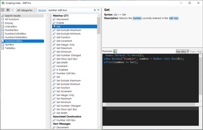

Depending on how you want to get the value, either use << get inside button box or sometimes you might have to use << Set Number Changed . Below is example from Scripting Index using << Get
Names Default To Here(1);
New Window("Example", numbox = Number Edit Box(0));
Print(numbox << Get);
That did it! Had a little trouble with demonstrating with Show() that the variable changed, but once I included it in the New Window command, it worked fine.
