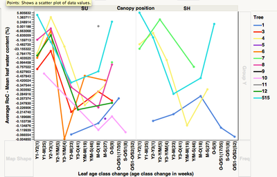

I have so far created a first group of line graphs representing the different physical (leaf thickness, area, dry weight, etc.) and chemical properties (%C, %nN, etc content) of my leaves as they age. The evolution of one such graph for leaf thickness, can be seen in the history of these posts. With your help, I successfully created line graphs that represent the mean values of groups of leaves of each leaf age per canopy position per tree. I am now trying to create a new group of graphs to represent the average rate of change (avg RoC) for these same physical and chemical from one leaf age to the next. However, I have run into problems quite early. I calculated the avg RoC (avg RoC=y2-y1/x2-x1) from the mean values for the different leaf properties in excel and then imported the data into a new JMP datatable. However, when I tried to create line graphs for the avg RoC things started to go wrong again. As you can see from the graph below, the negative Y axis values have for some reason been reversed and in the case shown below the greatest negative avg RoC with a value of -23.155… (I've double checked my data and this value is correct) has even been rearranged somewhere into the middle?! I have tried ticking and unticking the Row order and when I opened the Y axis settings window I find this line before the correct minimum and maximum values:
Format: 0 is -0.004850; 56 is 5.805832
I am guessing that this has something to do with it but I don't understand how it works or how I can correct it. I have also looked at the script for this graph and I can't find any reference to this. Could you please help me with this?
Many thanks in advance for the help,
Cecilia

Yes, that's a helpful clue. It looks like the average RoC column came is as a character column instead of as a number column, and JMP is treating it as just a list of names. You can fix that in the Column Info dialog. Change the data type to Numeric and the modeling type to Continuous.

Thank you so much for your prompt reply. Indeed, some of the numeric columns had gone into character mode. I have now corrected this and my graphs are making sense and showing amazing patterns, many, many thanks!!
