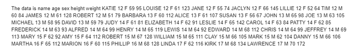

Hi, this is the print screen...I think the issue might be the fact that I am not using Outlook as the email client, I am using Mailbird. Will try to configure Outlook and update

Hi. is there a way the alignment per column be fixed? or if i could change the default font style used in this HTML email, cause it seems that the column is not align due to the letters in the default font style(arial) used takes different space per letter(like "I" has different space than "M"). so is there a way to change the font style or any other suggestion how to fix the alignment per column. thank you.
SDF1
Re: Using JSL to send emails
Hi @lalala ,
  Not sure if there is a way to do it with the commands that were listed previously in this thread. The text is just tab-delimited and you can edit it in the email. I am not aware of any commands to modify this when sending the table as text
  However, there is a possible workaround that might suit your needs. You have to get the data table report as a picture, save it, and then send it as an attachment. It will look like the data table format in JMP report windows.

Hi, it was indeed the email client. I uninstalled Mailbird and used Outlook and worked fine...
