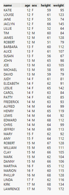

Hi, this is the print screen...I think the issue might be the fact that I am not using Outlook as the email client, I am using Mailbird. Will try to configure Outlook and update

  However, there is a possible workaround that might suit your needs. You have to get the data table report as a picture, save it, and then send it as an attachment. It will look like the data table format in JMP report windows.

  The attachment will look like this:
Not ideal, but the data will be formatted and aligned as desired. It won't be editable or copy/pastable like the text email version. Perhaps you can put in a request to JMP to have them provide more options for the Get Text() command so it can provide more complex formatting options?
