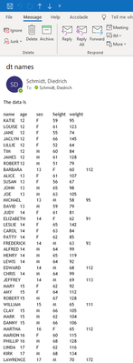

  That is really strange. I'm running JMP Pro 15.2.1 on W10 64-bit. This functionality is certainly not Pro dependent, so I can't imagine that's the case. When I run that code for the Big Class, I get this email out:
  Did you copy/paste the code exactly, with only changing the email address? If the code was changed other than the email address, this could impact the formatting in the email. Do you have a screen shot of the code and email you receive from JMP?
