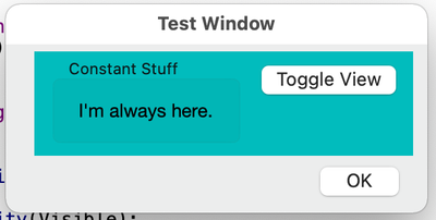

Hi.  I'd like to know how I can get a Modal window to resize automatically when some of its display boxes are collapsed.  Here's the window initially:

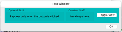

Then after pressing "Toggle View" to insert a display box to the left of the initial box.  All is well so far:

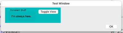

And finally after pressing "Toggle View" again to remove (Collapse) the display box I just inserted:
The container display box (a line up box, colored in cyan) has shrunk back down to the desired size, but the window still remains at its expanded size.  Any ideas on how I can fix this so that the window shrinks back down?  Interestingly, this problem occurs only if the window is modal.  Regular windows shrink back to their original size just fine.

Thanks for reporting this issue. I can confirm this is a Mac-only behavior that we have been able to address in a future release. JMP 17 will be available in the fall of 2022.

It appears to be a Mac thing.  The window properly collapses back down to the original size under Windows 10, for both JMP 15 and JMP 16
