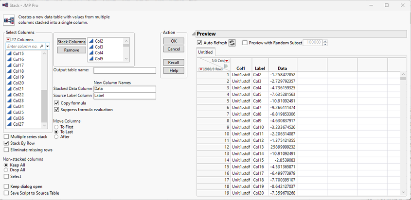

Data converted from STDF shows 2 units looped 40x times. Overall I have 80 test instances. I want to convert data from Col2 to Col27 into a single column as saved on "sanitized" sheet

Use
     Tables=>Stack
and select columns 2-27 as the Stack Columns and then click on OK

Use
     Tables=>Stack
