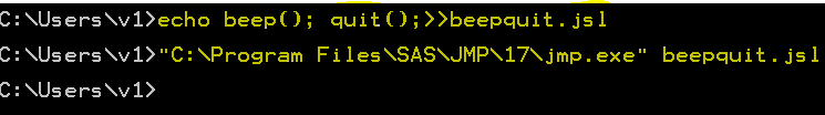

Craige_Hales
Re: [Urgent] How to replace Hotkeys in JMP
Change the python code to launch JMP with a command line argument that specifies the .jsl file, rather than launching the .jsl file with the //! at the start.
JMP seems not to be in the path, so I grabbed the executable+path from the icon.
Craige
