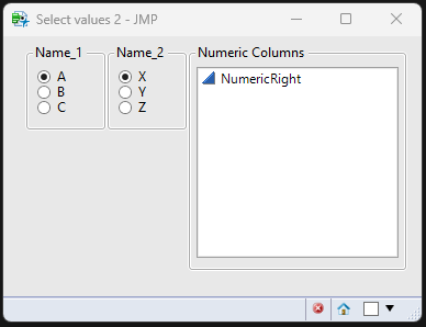

What I want to see:

What completely confuses me is that when I change the name of dt2:NumericInterference to dt2:NumericRight, I get this result:
Why is dt2 not letting my script do the work I want it to do? Why is the name change of a column in dt2 affecting what gets into the column list box? I've tried a few variations of moving the colList variable and also tried wrapping it into Eval List(), without "luck".
