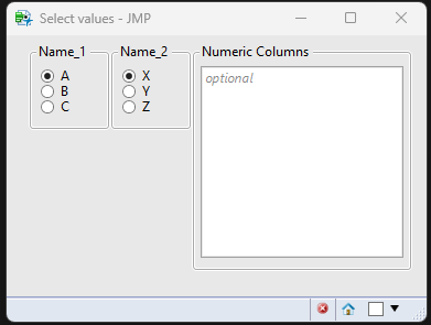

What I want to see:

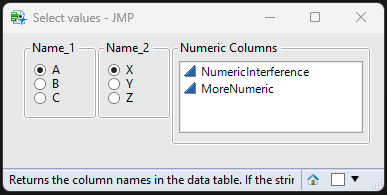

What I invariably see if my "target table" is not the current table:

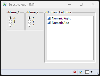

What completely confuses me is that when I change the name of dt2:NumericInterference to dt2:NumericRight, I get this result:
Why is dt2 not letting my script do the work I want it to do? Why is the name change of a column in dt2 affecting what gets into the column list box? I've tried a few variations of moving the colList variable and also tried wrapping it into Eval List(), without "luck".
Searching again in the community I found this Need help with populating Col List Box. If there's another solution, thanks for letting me know. Alternatively, is this how it is meant to be, and if so, what is the meaning of this?

Seems that the col list box just accepts columns from the data table which was "current" when the col list box was created.
If dt2 doesn't contain the respective column, it cannot be added.
I guess
current data table(dt);
// window with radio buttons & col list box
New Window( "Select values",
is no option for you?
If not, then use
clb = Col List Box( Data Table(dt)	)
to specify which data table should be used for the col list box:
