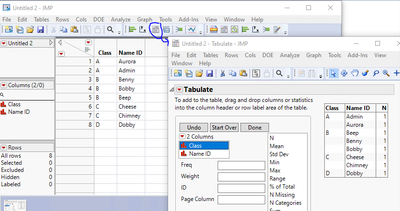

Can Tabulate helps to re-group after update?
