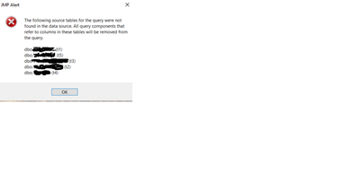

4. During reopening previously saved query, at each time JMP is unable to find source table and below comment appears.
In effect I need to made query from basis at each time.
Does anybody had this problem? Do you know solution?

Some Query Builder Files are having issues opening seems to have similar issue but there is no solution.This might be something you want to contact JMP support to assist you with but I will tag @Jed_Campbell as he did post to that other question (could database structure have changed?) .
-Jarmo
Re: Reopening saved Querys
Another thing perhaps worth checking is if the name of your connection has changed. This would likely mean a mismatch between the name of the connection in JMP and the name of the connection in your ODBC Data Sources app (assuming you are in Windows).
