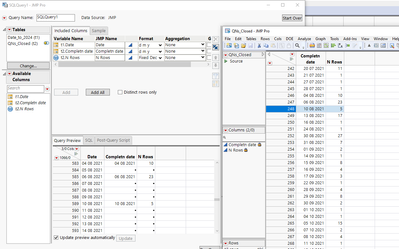

SQL (it doesn't get much simpler)
SELECT t1.Date, t2."N Rows", t3."N Rows" AS "N Rows 2"
FROM Date_to_2024  t1
	LEFT OUTER JOIN QNs_Opened t2
		ON  ( t1.Date = t2."Created On" )
	LEFT OUTER JOIN QNs_Closed t3
		ON  ( t1.Date = t3."Completn date" )

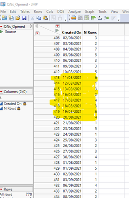

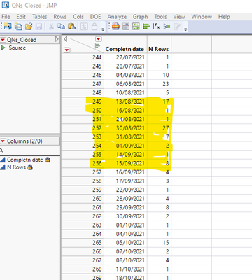

Table 1:  (Plenty of Data occurring after 10/08/2021)
Table 2:   (Plenty of Data occurring after 10/08/2021)

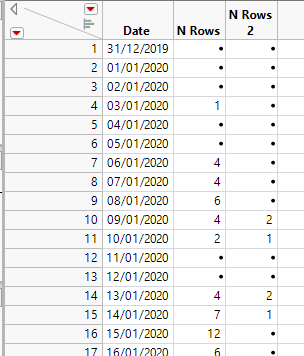

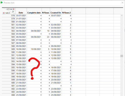

Query Result
Data from table 1 ("Created on",  "N Rows 2") - Correct.
Data from table 2 ("Completn Date", "N Rows") - Correct until 10/08/2021, then no further data.

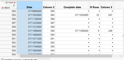

@Jed_Campbell you have to go more down, it is 10th of August 2021 when the issue occurs (or after it)
I also tried checking with jmps datetime values and still the same issue
QNs_Closed.jmp has one empty row, after removing it the query started working properly. No idea why.
You can see this happening in the preview, create query with the row still there, build query, open review, delete the row and update preview
