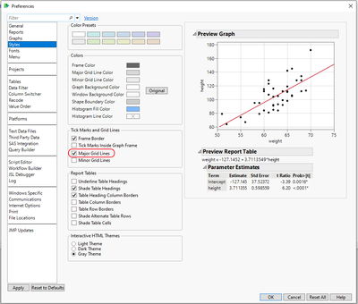

Alternatively, you could go to Preferences/Styles to activate Major Grid Lines.
But there doesn't seem to be a default setting for Tick label orientation :(

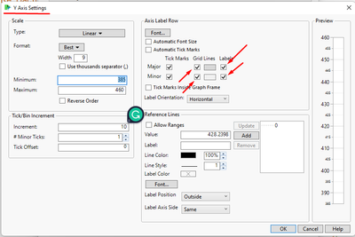

Is there no option to activate these regular settings in the Y-axis too?

The major/minor grid lines settings n the preferences activates X & Y grids.
But they are just applied to new graphs - could this be your issue?
