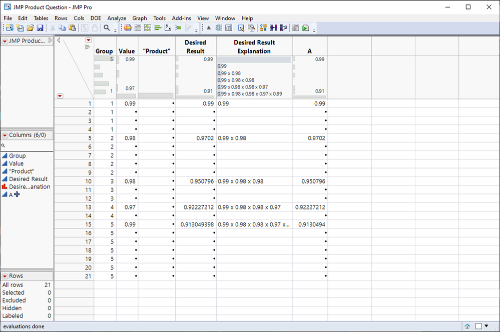

I'm trying to write a column formula that will calculate the product of all of the (non-empty) rows up to the current row.

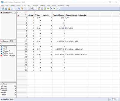

I've attached an example data table (& screenshot).
I am trying to get the "Product" column to be the product of all of the non-empty rows from the "Value" column. I show the manually calculated result and math in the "Desired Result" & "Desired Result Explanation" to the right.
A couple data set issues I tried to highlight in the example data table.
1. The number of rows per "Group" will vary between groups.
2. The "Group" will always be together and in order. All group 1 will be together. Group1 will always come before group 2.
3. The Value column will only have one non-empty row per group. It will always be the first row of that group.
I think this might require a "loop" or "for" type of formula, but have limited experience with building these up.
Even if you don't have a solution I appreciate any thoughts or links to guides or other discussions you think might lead me to a solution.

One option using the knowledge that the value is always found from the first row for each group
If(Row() == 1,
	val = 1;
If(Row() == Col Min(Row(), :Group),
	val = val * :Value;
Edit:
And here is other checking if :Value is missing or not
If(Row() == 1,
	val = 1;
If(!IsMissing(:Value),
	val = val * :Value;
You should also be able to replace first If with As Constant
As Constant(val = 1);
	val = val * :Value;
-Jarmo

Thank you Jarmo, worked perfectly!
