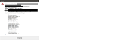

Unable to open Excel file from sharepoint using JSL JMP code.
Attempting to use the following JMP JSL code:
dt = Open("https://name_of_file.xlsx?download=1",
	Worksheets( My_Res ),
	Use for all sheets( 1 ),
	Concatenate Worksheets( 0 ),
	Create Concatenation Column( 0 ),
	Worksheet Settings(
		1,
		Has Column Headers( 1 ),
		Number of Rows in Headers( 1 ),
		Headers Start on Row( 1 ),
		Data Starts on Row( 2 ),
		Data Starts on Column( 1 ),
		Data Ends on Row( 0 ),
		Data Ends on Column( 0 ),
		Replicated Spanned Rows( 1 ),
		Replicated Spanned Headers( 0 ),
		Suppress Hidden Rows( 1 ),
		Suppress Hidden Columns( 1 ),
		Suppress Empty Columns( 1 ),
		Treat as Hierarchy( 1 ),
		Multiple Series Stack( 0 ),
		Import Cell Colors( 0 ),
		Limit Column Detect( 0 ),
		Column Separator String( "-" )
generates an error:
Anyone had a similar problem?
