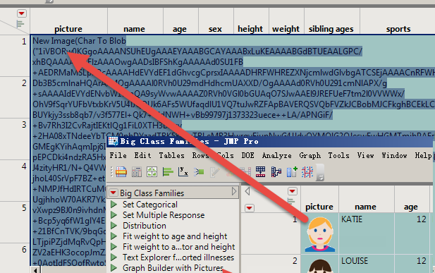

1. Can the picture in the "picture" column be imported from the computer's hard drive or from the Internet?
For example, how to use the JSL implementation to add "c:\1.png" to dt[1,1].

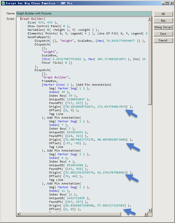

2. How the script "Graph Builder with Pictures"s:
"UniqueID(1180683047)," and "Origin({70.1036850751071, 172.033784817876})," are determined.
How can these numbers be computed using functional formulas?

For part of question 1, something like:
NamesDefaultToHere(1);
pic = Open( "$SAMPLE_IMAGES/tile.jpg", jpg );
dt = New Table( "Table with Images",
				Add Rows( 1 ),
				New Column( "Image Column",
					Expression,
					"None",
					Set Selected,
					Set Values( {Empty()} )
Wait(3);
Column(dt, "Image Column")[1] = pic;
5 REPLIES 5

"UNIQUEID (1180683047)," I cannot find it in the original file.
Thanks Experts!

I continue to ask: how to use JSL directly on the screen and then write dt[1,1].
For example, take a screenshot of the logo in the upper left corner of the JMP.com page and write dt[1,1].
Thanks Experts!

  • Try this, too. Thank you very much!
pic = Open( "http://……=000001", png );
				Add Rows( 1 ),
					Expression,
					"None",
					Set Selected,
Wait(3);
