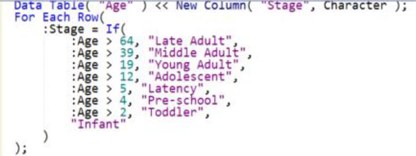

I think that Jim already answered your question, but I wanted to expand a bit on the answer. The If() function in a formula or script is very versatile. Here is an example of what you want to do (bin data) from our JMP Software: Introduction to the JMP Scripting Language:
It compares the numeric value in Age with the cutoffs and returns a character string in the new column, Stage.

I tried to follow this example using a column formula.  I get no error but the column is blank.
Craige_Hales
Re: Turning a continuous variable into a discrete variable
if "Pilot A", etc, is a string, it needs quotation marks. There might be a message in the log about an undefined variable.
