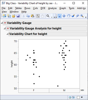

Which operating system are you using? Which JMP17 are you running? I tested with JMP17.2 on windows 10 and for me there were no box plots and if I change show box plots to 1 it will plot them.
Names Default To Here(1);
var = dt << Variability Chart(
	Y(:height),
	Model("Main Effect"),
	X(:sex),
	Sigma Multiplier(6),
	Analysis Type("Choose best analysis (EMS REML Bayesian)"),
	Variability Analysis(
		:height,
		Show Range Bars(0),
		Show Cell Means(0),
		Std Dev Chart(0),
		Points Jittered(1),
		Show Box Plots(0)
Is anything printed to log?
How do your preferences look?

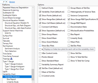

When Box plots are enabled via the preferences, I can disable them via (JMP 17 & 18):
Show Box Plots( 0 )
As an alternative, you can try Ignore Platform Preferences(1).

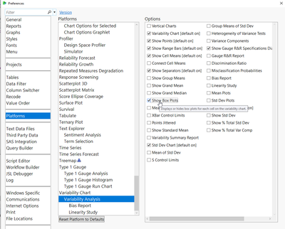

Mine is 17.0, and I have the "show box plot" box checked in the preference.
