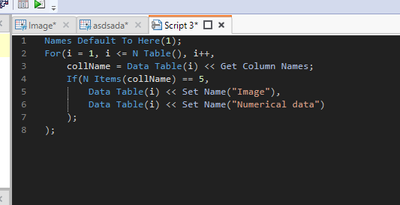

I am trying to rename opened data tables in a project. I have two data tables, one has columns, the other one has 16 columns. I want to name the smaller data table as "Image" (this data contains lots of pictures) and the other one as "Numerical data".
My code works - for the first time. After the code changed the data table names correctly, If I manually change the correct named datable to something else, and run the code again ( I want to test the robustness of the script), it will not work.
Any suggestions are welcome!
Names Default To Here( 1 );
For( i = 1, i <= N Table(), i++,
    collName = Data Table( i ) << Get Column Names;
    If( N Items( collName ) == 2,
        Data Table( i ) << Set Name( "Image" ),
        Data Table( i ) << Set Name( "Numerical data" )

Depending also where are you running your script from, you might have not access to your project. Projects have their own namespace(s).
Names Default To Here(1);
project = New Project(
	Run Script(
		Open("$SAMPLE_DATA/Big Class.jmp");
		Open("$SAMPLE_DATA/Probe.jmp");
For(i = 1, i <= N Table(), i++,
	collName = Data Table(i) << Get Column Names;
	If(N Items(collName) == 2,
		Data Table(i) << Set Name("Image"),
		Data Table(i) << Set Name("Numerical data")
vs
	Run Script(
			If(N Items(collName) == 5,
And if I run this from project (using JMP17) it does work for me
