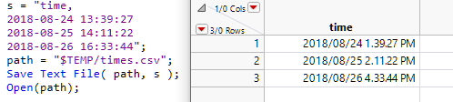

When I changed my Win10 time separator to "." and ran the following script below, it seemed to work OK, so I'm missing some detail.
 Regardless, here are a couple things that may be useful for your case.
  • There is a JMP global preference under "Windows Specific" for honoring the system locale settings or not
  • If you import the column as text and parse it later, the Parse Date() function has an Use Locale argument that you can turn off.
s = "time,
2018-08-24 13:39:27
2018-08-25 14:11:22
2018-08-26 16:33:44";
path = "$TEMP/times.csv";
Save Text File( path, s );
Open(path);
s = "time,
2018-08-24 13:39:27
2018-08-25 14:11:22
Open(path);
