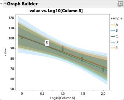

maybe try log transforming your time variable then use the stability platform to get the lower 95% CI (not tolerance interval) for the crossing time.
