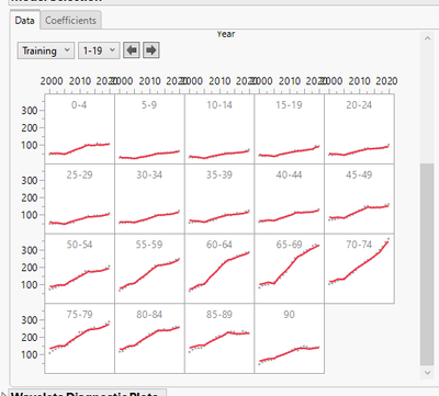

Do you have JMP Pro? If so, you could likely use the Functional Data Explorer (FDE) to make models that could be used to make predictions. In the attached table, I stacked the data (only kept the N.L. and Population columns; didn't keep HC Expense and Canada columns). Screenshot below shows models for expenses fit to each of the age groups, using population as the Frequency for weighting. I'm not sure that's exactly what you're looking for, but there are many different ways to model in the FDE platform. Here's a link or two to relevant material on FDE.

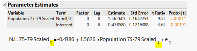

The first model, look at the formula picture. It says Scaled NL at time t is an intercept, plus a weighted value of Scaled Population at time t, plus an error. So this is just a simple linear regression. One can use Fit Y by X platform and get the same result.
But look at the residual plot below. It indicates, there are still unexplained patterns.

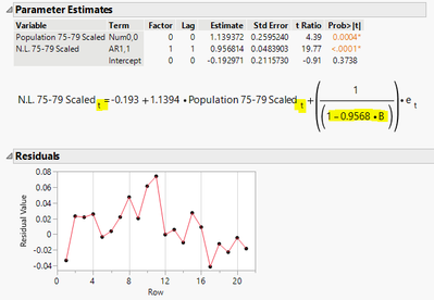

Now bring up the third model:
Its main part is the same as the first model, a simple regression, but the error term looks complicated. As you get familiar with the notation, you will recognize that the notation means: Scaled NL at time t involves it past value at time t-1. In summary, this model says: Scaled NL at time t is the sum of a constant, a weighted Scaled Population at time t, a weighted Scaled NL at time t-1, and an error term. So we are having more complicated models. And look at the residual plot, there are fewer obvious patterns.

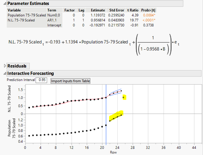

And seems there is at least one model fit the subset well. Let me use the third model. And look at the "Interactive Forecasting" part.
The highlighted markers are draggable. They should be self-explained if you move them. But to emphasize, the markers in the bottom frame represent future input series values. If you can forecast future input values, you should put the markers at desired places, and the output frame at top should show what the forecast on the response series looks like. Future input values can be imported in other ways, which I am not going elaborate (there is a button above the plot indicate its purpose for that.)
So the above is an example of using Transfer Function Model to analyze and forecast a subset of your data. But does not it make sense? To me, I am not sure. Your data is quite rick. The model fit this subset well. But it does not fit all subsets well. And I will leave that to you to conclude.

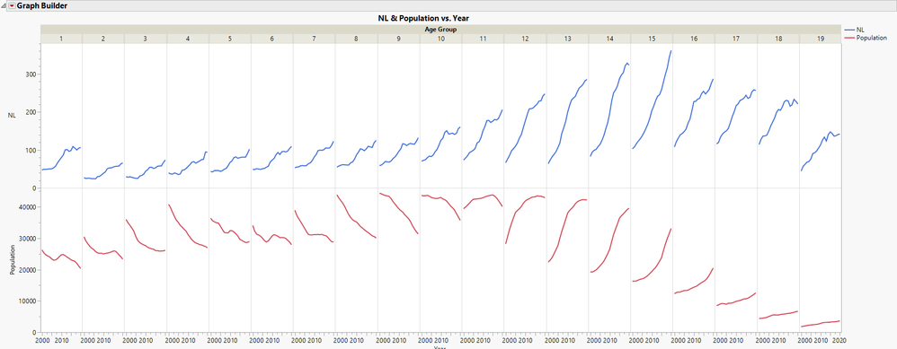

I did a plot to summarize what your data look like by age groups. The blue lines are NL series by age groups. And the red lines are corresponding Population series. All NL series have up tick trends. The Population series have downward trend for age groups younger than 50; and have upward trend for those older than 54. Several wonders:
  • What this picture will look like next year, the year after, and so on?
  • How to explain the cutoff at 50-54 group? And how to interpret the opposite trends between NL and Population for younger age groups, but same trends between them for older age groups.
  • What do the wiggles at the end of NL series try to tell? They look interesting to me.

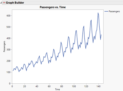

And if I look at the 21 frames on the top as a whole, and put them in a single frame consecutively, it reminds me of the famous airline passenger data, for which an seasonal ARIMA model is well known.
