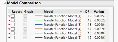

The subset is the 75-79 age group. It has an embedded script, which fit a bunch of Transfer Function Models. Run it. And you should see the following table. Use the check box to bring up the report one by one. And I am going to explain what they are. (BTW, I scaled the data. If I use the original data, the algorithm has trouble in some cases due to extreme values.)

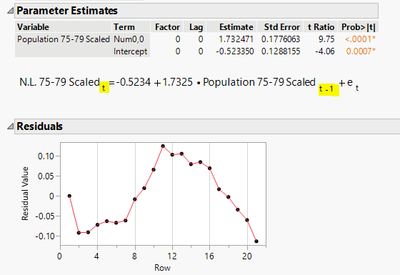

Now bring up the second model and look at the formula and residual.
The formula still looks like a regression. But the subscript on Scaled Population is t-1. This model says Scaled NL at time t is the sum of a constant, a weighted value of Scaled Population at the previous time t-1, and an error. So this model won't be easily fit in Fit Y by X without some data arrangement. Anyway, this is still not a good model, according to residual.

The 5th and 6th models get more complicated, but unnecessary. But I leave them there to give you a sense how complicated things can go. And these examples are still considerably simple.
So as a summary, Transfer Function Model can be as simple as a simple linear regression, or more complicated by representing the response as a seemingly convoluted sum of historical values (and/or current for inputs) of response and input series values.
